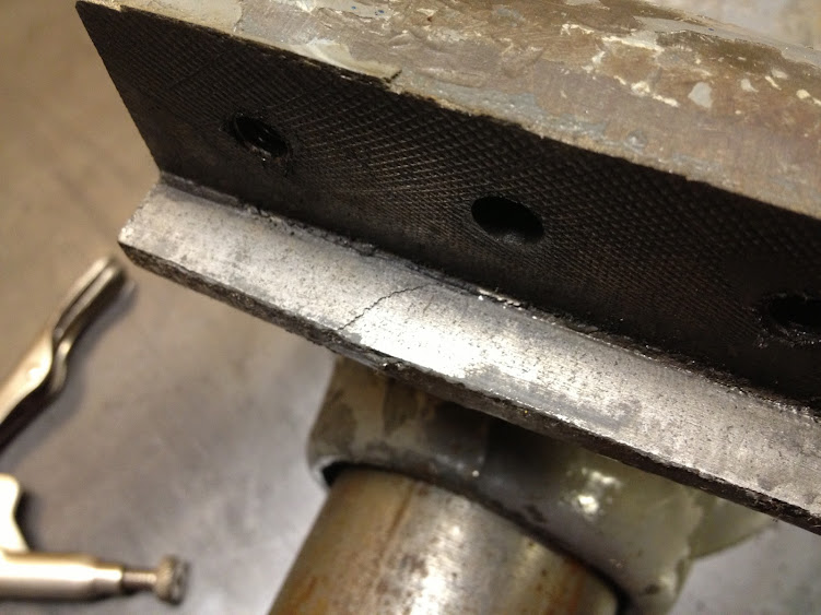

I bought a used wilton vise online. My first wilton. :) It's a 101157 model number. I got it for more than what most people would pay on here but it still was a good price for eBay. Ups stops at the house and I'm like a kid on Christmas! Then I spot it. A crack. :(. Ruined my night. How bad is it? Should I be worried? Anything I can do?
The listing number was 400525544513.
It was hard to see the crack from the listing. But here a is a better picture.

I had to use the auction pics to take a look but a crack like that isn't the end of the world. That occurs when somebody gets a bit too randy with a hammer and pounds down a bit too hard on top of the jaw inserts. Its one of the more delicate parts of the vise casting so it understandably breaks. Another weak spot is where the dynamic jaw fits into the stationary jaw, right at the edge of the casting. Wiltons don't have a large support piece and they get broken often.
The damage isn't too bad and consider yourself lucky that it wasn't worse.

The crack is pretty clear in the seller's second image when you click the full size image (which you should always do).
Is just the corner of the ledge cracked or the entire ledge? If it's just the corner it'll be just fine. If it's the entire ledge then I'd use his 14 day satisfaction guarantee.

Wiltons are cast steel as opposed to cast iron? I don't know, but either can be welded. You can't do the thing any more harm. If you can return it or get a partial refund, I'd try that first. I only posted because all is not lost.

I haven't contacted the seller yet but I do plan on it to see what he says... The damage is clearly visible from the pictures but I must have over looked it. It would seem to me that the seller should have mentioned it in the listing though.
To me the crack is probably isn't in the worst location. It only goes to about halfway through the ledger. I will see if I can get a better picture.

Leavoing aside the Eprey issues, If it were mine, I'd get get the jaw insert out and stop drill the end of the crack, then clamp it and die grind a Vee where the crack is and braze it. Preheat the whole thing in an oven prior to brazing, and then bury it in hot sand to cool. after it cools (overnight?) pull it it and file the excess braze material out of the jaw pocket.

Depending on how bad the crack is, either go the brazing route, or maybe even some JB Weld can fit it up if it's not too bad. Need more pics to see how big the crack is underneath.

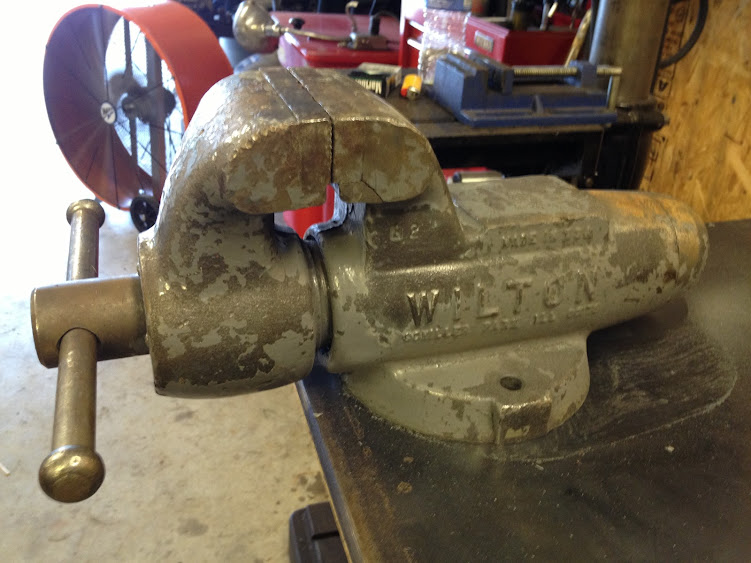

Send it back. That's a large chunk ready to break off. (all the way to the middle!! Not just a little corner)

Just cracked on one side. It's hard to tell if its all the way through, I can only tell where the crack is in the exterior. But it follows the ledger all the way over to just past the middle as you can see. Underneath the static jaw you can't see any signs of the crack with the exception of what your see from the side.
I am so bumed about this. :(.
I've been needing a vise for a while but have been holding out for a wilton bullet.... Now I guess I'm back to holding out. It's a pain in the *** to clamp things to my bench!!
Not true. Wiltons are nodular cast iron. That is not weldable.
Is this true? That is what third members pumpkins and drive shaft yolks are made out of. This type of cast iron is very tough, I have welded it. I used Eutectic 680 tig rod and had luck. I would be real surprised if Wilton's are made from this type of steel. I do not believe the shoulder under the jaws would have cracked like it did if it was nodular iron. It would have cracked the whole way at the corner. A real weakness of Wilton's. If it was mine and I was to repair it I would channel out the crack and weld it with 680 Eutectic tig rod or use Eutectic 224. If you use brass then you are stuck with brass, can not weld over brass.

That's a hell of a lot more crack that how I understood your original post. Bummer!. Well if you can't get a complete refund you could also pin the jaw to the casting so your not completely relying on the bolts for shear strength.

It is weldable. But maybe you mean to say it will never be as good as new. :D
I wouldn't attempt it but I don't weld cast iron for a living either. There are people (specialists) who weld cracks in the old cast iron cylinder heads for a living. But I still wouldn't trust it with a vise.

Cast iron cylinder heads are not nodular iron. You've got as good a shot with JB Weld on a Wilton vise as you do with any real welding or brazing process.

Anyways, what i would do is. Ask for $50 to $70 back. V the crack out, get your heating torch out, heat it up hot as hell, get flux core mig wire turn it up as hot as you can and melt some steel in there..........it will weld trust me i have welded on two Wilton vises one a 70's model and one a 2000 model. They will weld and it will be strong enough as all of your load should be in compression (if using it correctly) and your vertical load should be taken by the center pin and two bolts as long as you don't beat on it like the last gorilla did.
Where do you get that nodular cast iron is not weldable? :dunno:
Sure it won't be the same as before it was welded, but it IS weldable.
