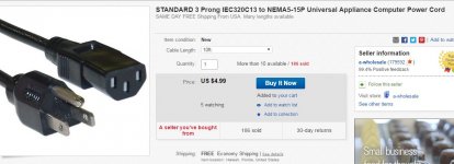

what about something like this? I can do this and a $.50 strain relief and it would be cheaper than the shielded wire.

Norcal already posted it above - 400.8(1)
That is for building wiring such as from the panel to the outlet box to where the lighting fixture is connected.
I think you're misunderstanding the intent of that code article. Take a look at 400.7(A)2.
You are correct. You can go in to many industrial styled restaurants etc. and see hanging strip fluorescent light fixtures wired with cord to a ceiling mounted box.

I bought 10 each of these. little more expensive than chinese but local. If they work out ill bulk order the rest
