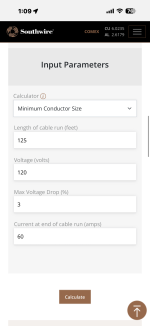

you selected the wrong voltage. should be 240v not 120v
It only gave me the single phase option. I wasn’t sure what voltage to use when thinking about an individual conductor. Since L1 to neutral is 120V.
Entering 240V gives me this. But I’m not real comfortable I’m going about this correctly.
