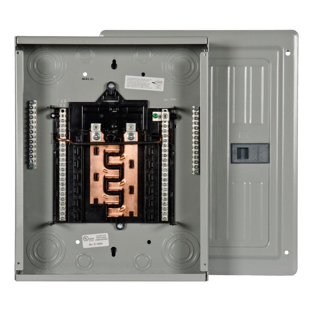

I've finally roughed in my small (12x14) workshop and am ready to hook up the sub panel. Currently I have 4 circuits.
As I've posted previously, I ran a 10/2 UF-B wire several years ago before I knew I would ultimately build a workshop. This will provide 30A at 110V and is plenty of power for me as I mostly work with cordless tools (the shop is too small for large machines anyway). I mostly just need a space to work with lights since I don't have a garage. I have no plans to run larger wire as this would be prohibitively expensive (at least $1,000) and unnecessary for my needs.
A while back I purchased a nice copper bus Siemens 12-space load center. This is much larger than I need, but all the reading that I did suggested to go with a larger panel so that adding more circuits in the future would be easy.
Today I read the info on the inside of the panel's door which lists compatible breakers, wire sizes, and torques (see attached photos). I was surprised to see that the smallest compatible main breaker is an MBK100A which requires at least #4 wire, and the installed lugs (listed as terminals A and B) also require at least #4 wire.
Am I correct that there is no way to use this panel with my #10 subfeed wire? If so, I guess I am learning the hard way that there is a major difference between "load centers" and "subpanels" aside from the number of breakers they accept. I have to wonder if people often violate the minimum wire size listed on the panel's lugs or main breaker...the lugs or breaker would screw down on the smaller wire, right?
What are my options? Here is what I can come up with:
1. Find a new panel that accepts at least 4 circuits (preferably full size) and lists #10 wire for the main lugs
***Does anyone know of such a subpanel?***
2. Spend $1,000+ on running #4 wire to the workshop
Does anyone have any other suggestions?
Thanks for reading!

Is this a main breaker or main lug panel. As long as the single pole breaker in your house feeding the sub is not larger than 30 amp you are ok. You will have to jump the buss or main breaker so all the spaces or energized. If this is a detached building, and you are planning on having more than 6 circuits, then you need a main. If it is a main lug panel, then just install a 2-pole 30 and back feed it. you will need a hold down kit. You will have to jump from one pole on the breaker to the other. Problem is the lugs are only rated for one wire. You will just have to pigtail from each and tie them together with your hot feeding it.
Remember to keep your neutrals and grounds isolated and if this is a detached building, install 2 ground rods
Is this the panel that you have

you could splice #4 onto the #10.
as said above you will need a main if more than 6 breaker handles and to energize all breaker spaces you will need to jumper the incoming hot to both sides of the panel.
Perhaps you could splice 2x short pieces of #4 onto the black #10 then connect them to the main breaker or lugs

Yeah I was going to add to my post, If he is not putting in a main, he could replace the main lugs with ones that accept smaller wire and just use one of the smaller lugs on the neutral buss. If he back fed a 30 amp 2-pole then # 10 would not be to small.

Terry, you are a life saver!
My panel is a main lug panel (fixed link). And the breaker for the subfeed in the home's main panel is a 30A GFCI breaker.
I did not know that you could "back feed" a panel with a regular breaker. I did a google search and Schneider Electric has a good explanation for the non-pro like myself.
So here is what I think I need to do:
1. Install a 2-pole 30 breaker in positions #1 & #3
2. Install a hold down kit (photo attached shows that Siemens ECMBR2 is correct for my panel)
3. Splice the incoming subfeed #10 wire's hot conductor into two (I have the correct size Wago wire connectors that can be used to do this)
4. Run the two spliced hot conductors to each side of the 2-pole 30A back-fed breaker
5. Install all the other circuit breakers as normal
Have I got all that correct? Thanks again!

Yep, also make sure you use one of the smaller lugs on your neutral buss since the large one is not rated for # 10

Thanks for that additional tip, Terry - I see that the neutral bus does have smaller lugs available for #10-#14.
One more question: when backfeeding a subpanel, do the main lugs remain installed and just end up unused?

Yep, just leave them unused.

That hold down bracket supposedly only works for breakers 60 amp and above. Size OK as breaker is for disconnect only.

I missed that. Good catch. OP, just use a 2 pole 60, #10 on that will be fine. The single pole 30 in your house feeding your sub will protect the # 10 from be overloaded
I think the Siemens Q260 breaker has a minimum wire size of #6 as shown on the photo below, so I think backfeeding a 30A breaker is still the way to go.
As it happens, I already have a 2-pole 30 breaker and the ECMBR2 hold down clamp because I had previously purchased them for an interlock kit to hook up a generator to my home's main panel (which I have not yet done). I can confirm that the hold down clamp (the red piece) does indeed hook into the breaker and screw down onto the panel. However, the black terminal screw cover does not attach correctly to the 30A breaker.
So the hold-down kit does indeed "hold down" but does not protect the terminal screws from someone with a screwdriver. The kit also comes with a "MAIN" sticker to apply to the top of the breaker to warn against using a screwdriver on the terminal screws. Do you think this is this good enough?
I believe main lugs have not been required (or even had the option) of plastic protection covers until quite recently, so maybe it is OK to install the back-fed breaker with the same logic?

I would say yes. I think the requirement has been out for a couple of code cycles. Not to much else you can do. The main thing is that the hold down will prevent the breaker from coming off the buss. I know it is a code violation, but there are alot of panels installed out there with the lugs exposed. Just if you ever dont feel safe working in there, just turn off the breaker in the house feeding it.

Thanks again, Terry. I will definitely turn off the breaker inside the home's panel if I want to work on the workshop panel.
Last night I called Siemens tech support. Surprisingly, open 24 hours. I got an American rep that was much more helpful than your typical call center rep. He could not answer my technical question but took my info and said an engineer would call me in the morning. This morning the engineer called me first thing at 8AM. He explained that the hold down kit is UL listed for a 30-amp double breaker even though there is no way to attach the terminal protector and consequently is code-compliant. He even stated that if my inspector had a problem with the exposed screw terminals that the inspector could call him and he would explain the same.
Very impressed with Siemens tech support - especially since I am just a DIY guy and not a pro!

The printed document is actually newer than the one available on the website and does mention the terminal barrier. Still no mention of the issue with breakers smaller than 60A though.IMG_3069.JPG
