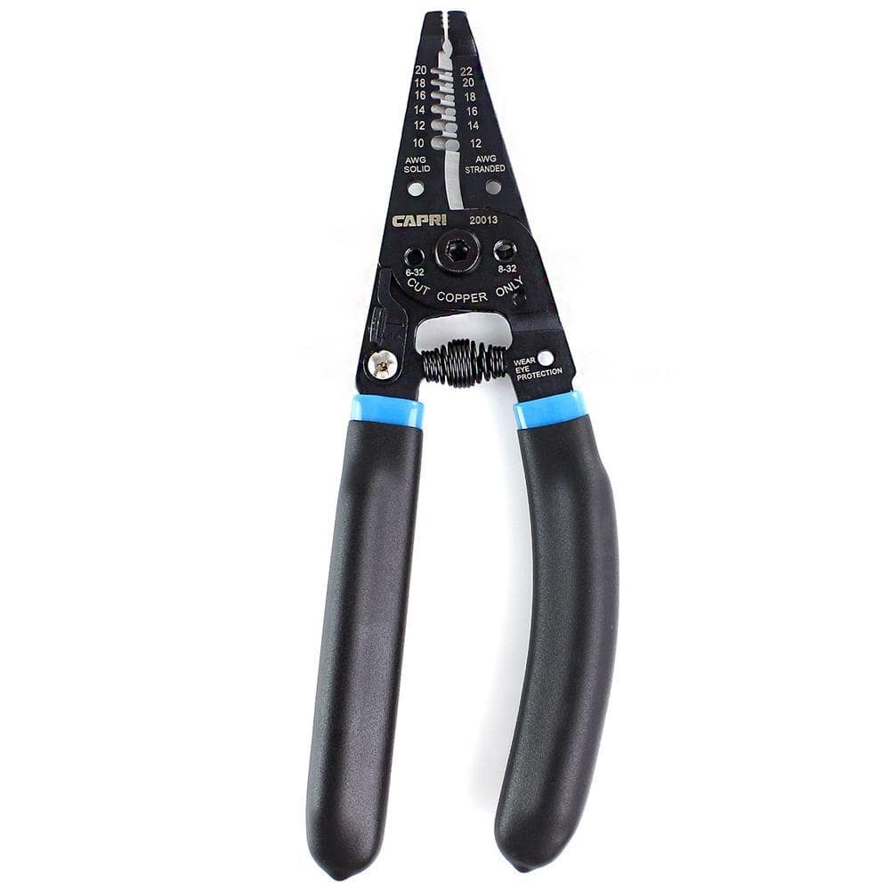

So a couple of things that will help you. Most modern receptacles use a multi-bit screw ( straight | phillips | #1 robertson ) so pick yourself up a comfortable #1 robertson screwdriver as they resist slipping.
Most of us use a short bucket with a padded lid instead of kneeling on the floor.
Personally I use these strippers...
They are comfortable for me and the hole in the stripper makes bending a loop in solid wire a cinch. Lots of companies have this style.
If I am dealing with lots of terminations, I use these as my wrists and elbow are not as young as I would like.
It means carrying an additional tool and an extra step but it does reduce my pain at the end of the day.
