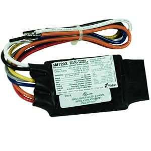

Anything special about wiring smoke/fire detectors? I want to install 5 detectors and have them all go off if one detects an issue.
Do the detectors have to be on a separate circuit or can they get power from any circuit.
I am assuming I must use 12/3 wire with the red wire being the interconnected wire between the units.
Any thing else?

Use 14/3, the smoke detectors barely use any energy... 12/3 would be a total waste.
Nothing special... on the Kidde at least, the white/black are the standard AC wires and the red is connected between all of them. You can buy relays that connect to external alarm systems as well.
I suggest installing them on a separate circuit, but the models you'll find are battery backup, so you could install them on something existing if necessary.

DO NOT INSTALL WIRED SMOKE DETECTORS ON THEIR OWN CIRCUIT!!!!!
Putting them on their own circuit facilitates turning the circuit off if there is a problem with one of the units.
Putting them on a commonly used circuit will require fixing the problem correctly.
Find a 15 amp circuit, and take a piece of 14-2 to the first detector, then take 14-3 to the rest. the red wire is for the interconnect.

Something else to consider, is to install a EOLR (End Of Line Resistor) to the smoke / co detector. This assumes this system is being monitored as well.
The intent is to ensure a measure of safety and security at all times with respect to the integrity of the fire system.
Should any of the units encounter a fault, bad wiring, etc. Using a EOL resistor will immediately detect such a fault.
Not using a EOL resistor will reflect a false sense of security for the home owner.

I was under the impression that EOL resistors were only for security systems - thus an EOL resistor is of little value on a straight interconnected fire alarm system. To be used on a fire alarm system, the security system must monitor the fire alarm system. Is this not the case?

For the residence these are battery backed-up alarms, there would be no advantage to turning the breaker off.
The 14-3 should be run to an access point if you ever plan on integrating with an alarm system, as you need to connect to it.

If it's a Kidde or similar home interconnected system, these are RF units and there is no point in using an EOL resistor. Not contact closure/opening. Not even sure what would happen if you did. You don't make a direct connection to the interconnect circuit, you have to use a relay module. (Two, if you had smoke and CO interconnected as I do.)

Don't know where this wireless talk came from. I was speaking about *wired* smoke alarms. For the OP this is also what he is speaking of. Now, if he is going to use a wireless smoke / CO then of course this has no play in the conversation.

I will not have a monitored alarm system and no need for CO detection either. I live in the country and by the time the monitoring service gets the alarm signal and the fire department showing up, there will not be much left so no need to spend the 30 bucks per month.
I had mentioned the 12/3 since that is what I used through out the entire house. I could etiher run a new dedicated circuit using 14/3 or tie into another circuit using 12/3.
I did speak to an electrician this morning from my area in our area, it does not need to be a dedicated circuit but they mucy be interconnected.

I have a hybrid wired and wireless system at the house. Kidde recently came out with a wired/wireless detector that acts as a bridge between commonly available wired (3-wire) AC smoke detectors and their line of wireless models. Not wanting to get up in the attic for the umpteenth time for another wiring project, I replaced one of my wired detectors with the combo unit, then installed three wireless units in the bedrooms. The wired units will trigger all the wireless ones, and vice-versa.
There is a module available that interfaces the typical 3-wire smoke alarm system to a monitored security/fire system. Smoke detectors designed for such systems are 4-wire DC-powered with supervision. This means that the alarm control box provides the power for the units as well as monitors their operation. It's here where the end-of-line modules must be used as a part of connection supervision. The 4-wire detectors have a pair of power wires, and a set of normally closed relay contacts that open when the alarm is triggered. The EOL module is basically a relay powered by the same source as the detectors, and a set of normally open contacts held closed by the powered relay. All the detector outputs are wired in a series loop, with the EOL module providing a specific resistance in the loop. The panel sees the closed loop with the specific resistance as being normal. When a detector is set off, the circuit opens, setting off the alarm at the panel. The supervisory function works like this: If all or part of the detector loop loses power, the EOL relay opens, setting off the alarm. If any of the detectors lose power or malfunction, their relays open up, setting off the alarm. If the detection loop shorts, the specific resistance is lost, the alarm box sees the low resistance and sounds the alarm. If the EOL module fails in any way the alarm goes off.
The 3-wire AC detectors are not a supervised loop, but do have some fail-safe measures. The alarms will go off if one of the detectors is wired wrong or one of the power wires opens, but there is no supervision of the signal wire. If that is disconnected, only that detector will sound if triggered, or won't sound of the others are. Still, installed correctly the three wire AC (preferably with battery backup) detectors are very reliable and simple to install.
