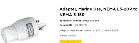

Further more, you and your amigos seem to like to gang up. When I pointed out that L5-20 to 5-15 adapters were UL listed (i did incorrectly say approved) Norcal said they were not.

When I posted a screen shot of Hubbles web page showing it was, Wyliediesels tried to infer that I forged a website to show it was UL listed. Then YOU come on and accuse me of cherry picking and list 3 "marine adapters" in an attempt to purposely confuse things further
And you accuse me of gaslighting.
