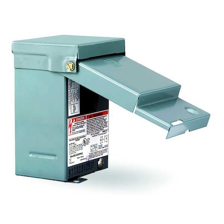

Picture is a Square-D QO200TR which can be purchased at HomeDepot or Lowes for about $16. It is a nonfused 60A A/C disconnect switch and is rated at 10HP. If your compressor motor is more than 3HP then a standard NEMA plug is not appropriate as a disconnect.
This is how I hardwired my compressor.

OP It does not matter if your disconnect is the same brand as your panel, it just has to be rated at least as much as your circuit, fused is not necessary. The one pictured by pattenp is a good example of what you need

The Square-D QO200TR pictured is a disconnect switch, it is not a breaker. A breaker is not needed in the disconnect. The 60A listing is not overcurrent protection, it's the current the switch can handle. Plus the switch is listed as being rated for up to 10HP.
The conduit is a #10 THHN/THWN A/C whip. Liquidtight conduit is the same and you buy the wire separate.
http://www.homedepot.com/p/AFC-Cable-Systems-Liquidtite-10-3-in-x-6-ft-AC-Whip-8015-HD/202286686
Edit: You can use the #10 AC whip for 40A because the wire is THHN/THWN and can be sized by 75deg C. Your romex needs to be #8 for 40A because it's 60deg C wire.

OK, Harbor Freight are going to send a replacement air compressor and pick this one up to go back to the warehouse. It's probably going to be another 2 weeks but I have everything wired now so I should be good to go.
Regarding this set up though, can I replace the 60A breaker that came in the paenl disconnect switch with a 40A one? When I was inspecting my main panel, I noticed there was an old 60A breaker looks kind of old and crusty so was thinking I could replace it with the one that came in the disconnect panel and put in a new 40A. That way I will have the compressor wired with #10 THNN AC whip to a 40A disconnect then #8 romex to the 40A breaker in the main to keep everything consistent.
U can only do that if the replacement breaker is listed and labeled for use in the breaker panel.
What is the brand and model of panel and the brand of breaker and model of breaker?
It is not a circuit breaker in that SQ D disco, it is a molded case switch, do not install it in a panel.
