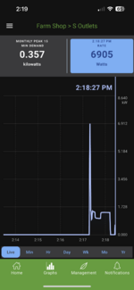

I recently purchased a 2nd dust collector that draws right at 12a when running but a staggering 57a for a moment when starting. I’m almost 100% sure that motor has no built in overload. Should every circuit I plug it into have an overload protector ?
The overload protection should be part of the dust collector.....either integral to the motor or and overload relay within a starter enclosure.
Provide pics of the motor and on/off hardware. Or the mfr and model #. It is usually very easy to confirm.

smaller cord and plug connected motors can get by with protection from the breaker (such as garbage disposals, furnaces, vacuums, etc). but it all depends on the motor, manufacturer, etc
the startup current is typical as in-rush current can be 4x-8x FLA
The dust collector is a different type of load vs the compressor. The compressor has some compression load on the first rotation of the pump. That can be really hard on the motor and if the oil is cold etc it's not unreasonable to think the motor would stall and trip a breaker. The dust collector fan has some inertia but other than inertia it has no load as it starts turning. For that reason it it probably is fine with a non-resetable thermal/over current fuse inside the motor.
