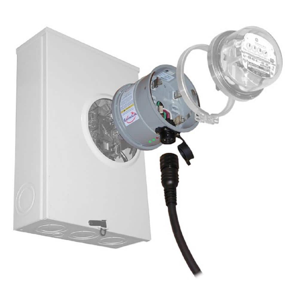

you'd need to bring the output from that top disconnect down to where the meter is, put a manual transfer switch in, then run the output/load from the manual disconnect back up to the top and send it out it's original aerial.
then some kinda input setup for the generator into the gen side of the manual transfer switch
if its a 100a then something like
another option, those pricey and might not be allowed by your poco:
