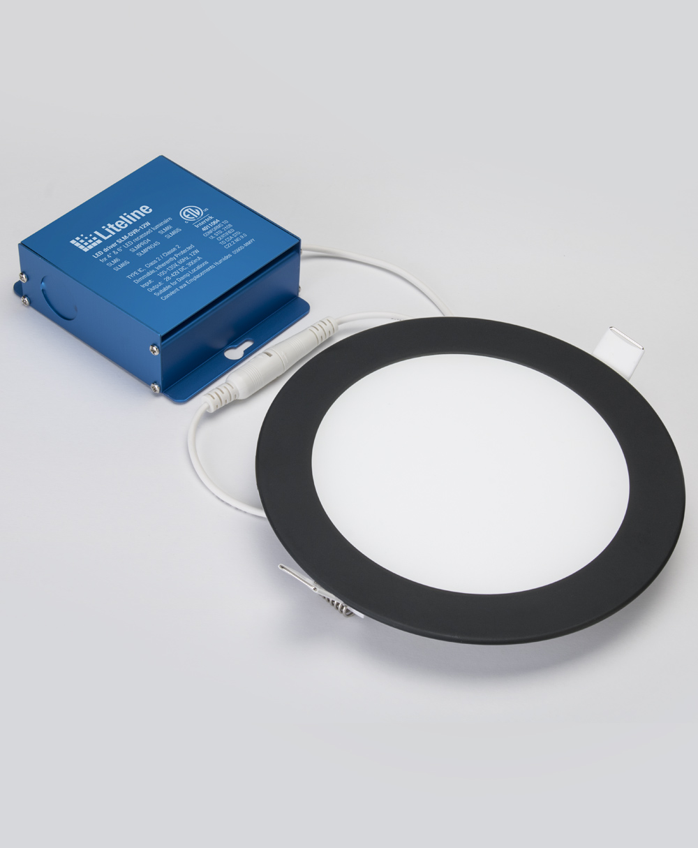

Use a wafer light instead of a pot light and none of that will matter.
CD
850xpeps
Aug 6, 2017
1,365
Yes with these wafer you can install on a truss. Just need enough room for clips to pass by. I installed some in last house a 3 landed on trusses. No issue. Putting a bunch in new house I love them

I found some wafer style lights that have the look of traditional pot lights that we're going to go with.
I've seen these being installed with the clips which seems fairly easy.
How do you take these out of the ceiling with breaking the dry wall, it seems like the spring clips are putting a lot of pressure on the dry wall.
They're not that strong. They hold the lights in really well, but if you get your thumbnail under the trim ring, or a plastic knife or a fork, you can pull it down.
Thanks for responding. I'll give it a little more force.
