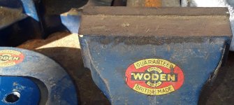

I found my Woden vice and it has the logo still.
One might easily take the image and make a water slide decal to finish off the nice restoration you have done.
Of course the stickers are not perfect but it might be a start

Just cleaned it up, and between the swivel base was original unfaded paint. I can say that the paint job above is so very very close that I would think it a match for the original color

Woden used several different colours on their vices. Older ones seemed to be red or green, as (surprisingly) shown in this colour catalogue from 1924. I saw a Woden vice once in a pale green that I assumed was an old repaint, but might not have been.
I have a small Woden vice purchased new by my Grandfather in the 1930’s and it’s a much darker green. I’ve seen woodworking vices, and other tools, finished in a bright green.
The blue vices seem to be newer. I’ve seen many that I’m sure are original, and it’s a slightly brighter shade of blue than the British Standard “Roundel Blue” used by record, but as you say, very close.
Repro decal’s are available from www.isaydingdong.co.uk and look decent.
