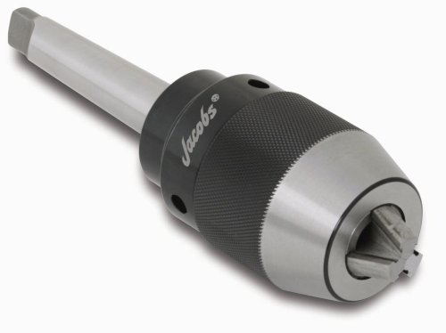

I also just ordered a Barracuda 2 4-jaw chuck and a 1/2" drill chuck so I can start doing some more intricate work.
