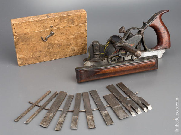

Not exactly the same plane, but some interesting similarities
Just to complete this thought, here is the "unimproved Phillips" plane
13,441
And here is a different Phillips that looks more like yours
And the patent for Phillips improved by Mayo

Yes, that looks like it. I also found one listed on ebay. Mine is in very rough shape but I will give it a light cleaning to see if it has any identifying marks. I am not a plane collector but couldn't leave it behind at a recent barn sale, it just looked old. Thanks for your help.

I've got one that looks to be the same.
The makers mark stamp says:
Phillips Plough Plane -Pat Aug 1867
Babson & Repplier
7 Doane St Boston,
And is stamped with the number 85 in several places.
I am looking to make a handle for it and put it up for sale. Any suggestions what you folks might think it's worth?? I have found one in nice condition at about $800, and another in very nice condition with cutting blades for about $1300.

This reply is for Gmann555: It's a Phillips Mayo Improved like this one. I'd sell it as is. Let the next guy make a handle. If you don't do a perfect job using Brazilian rosewood, it's not going to add to the value. That new depth stop isn't helping either. It's distracting to people that know these planes. I think you'll be lucky to get $500. for it. 4741E351-3BF6-41BC-92BF-FA8FED4FBFBF_1_201_a.jpeg
