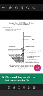

I am building a 12x16 shed.
It will be wood floor.
The City requires a Wood Rat wall with a wood floor (see pic)
How would you attach this to the floor?
Just nail it to the outside of the rim joist?
Forgive me I need simple instructions and pictures would be better.
Thanks

I would ask about laying hardware cloth (wire mesh with 1/2" square holes) on top of the joists with the plywood floor on top of that. Then you just nail through both the plywood and hardware cloth. No rat is getting through that. And if you decide to move the shed you don't have to deal with a rat wall going 12" into the dirt.
To answer your question however, nail or screw the wood for the rat wall backing to the 2" side of the 2"x4" shown in your drawing that is laying on it's 4" side.

1/2" plywood will not deter, let alone stop, even a moderately motivated rat. Install it in whatever manner is most convenient that will satisfy the inspector.
I agree. I talked to the inspector and he told me to just use 1/2" because it's cheaper.
Go back and look at the plan in the first post. The plywood is "a continuous nailer" for the rat wall barrier. So the plywood is just a nailer. I suspect metal flashing is the actual rat wall barrier.
Agreed, but since no "rat wall barrier material" is specified, none is required to be installed. The correct solution remains to ask the inspector what is required to pass and then do that.
