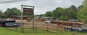

I'm used them before for Cherry wood. Good shop. Will sometimes give you cutoffs from their winter furnace barrel.
The local woodworker's guild also has a materials shop for members.
There's another mill south of Simpsonville on Hwy 418 that processes lots of logs.
Have to speak to them directly, though.
Arrow Straight
201 Nash View Dr, Fountain Inn, SC 29644
