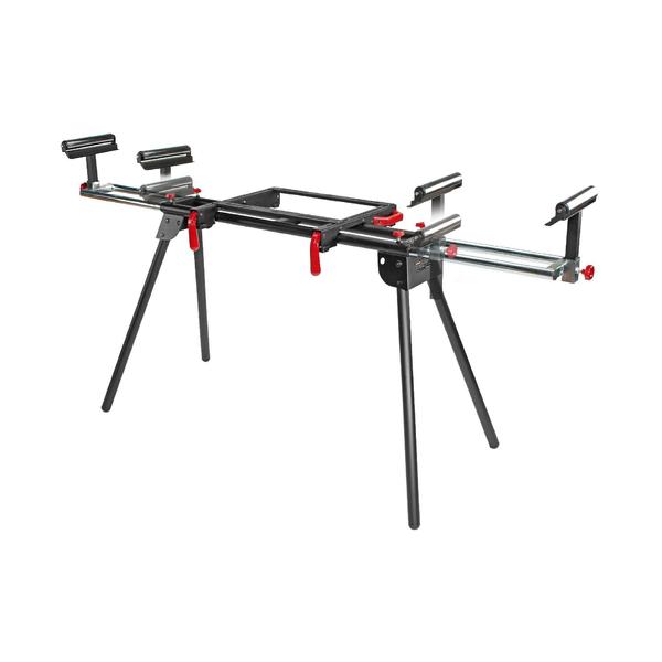

Hey gus,
I'm fairly new here. Been lurking for awhile but this is my first post. I hope this is in the right place. I'm getting ready to build a table to mount my mitre saw on. It's a fairly large, heavy compound mitre saw and I need the table to be mobile (on casters) because I generally do all of my wood working just outside of my shop doors. I've considered buying a good dust collection system but I weld inside a bunch and just feel better about having sawdust outside rather than inside. I am starting to get into wood work more and want to figure out the best way to set this up. I am going to be buying a router soon and I'm wondering if I should mount the router on the same table as my mitre saw or if I should mount the router to my table saw ( I have seen it done on the same model table saw that I have). Space is not as much of a concern as mobility. I like the idea of one big saw/router station but I want to think it through all the way before I dive in. Anyone have a set up like this or foresee any issues?

Welcome!
Personally, I'd use two different tables -- the way those two tools are used is very different, IMO. I like using a specialized miter saw stand, which is available with wheels. My miter saw is a big one, but it's still easy to remove it from the stand (the portable stand came with quick-detach levers for the saw and carrying handles).
spin_prod_730935012
I also have a portable router table that folds up for storage.

CJ - Check out a StableMate Plus100 uon Amazon. It is a universal miter saw stand that should work with any miter saw. I have had two of them for years and think they are well thought out and sturdy.
It is very portable, your miter saw can be removed quickly, folds up and can be easily transported or stored when not in use.
I would mount your router on your table saw if that is an option that would work. That is how I have mine set-up, drops down out of the way when not in use and you don't take up any more space in your shop.
Just one approach that works for me, :thumbup:

Thanks for the input guys. Good advice all around. Seems like mounting the router on the table saw might be the way to go since I can use the existing fence and the table saw is already on wheels.
ford33, that "Ultimate Tool Stand" link is great. That might be the way I go for a miter saw stand.
