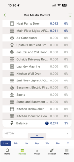

The last two days have been incredibly long, 12-13 hours laboring away at a project long overdue. When we purchased our home it had a basement apartment. Two meter bases, and two 100 amp panels…with fuses. Aside from the extra meter charge ($37/month) the two panels also conflict with future solar plans and were otherwise overdue for replacement. My brother in law is a sparky, and a great one at that. I handled tagging circuits and removing the old 100 watt panels while he tended to the new 200 amp service.
Power was disconnected to the house at 1 pm Tuesday. My brother in law focused on getting the new meter base and 200A service tied into the new panel.
Today (Wednesday) the ESA inspector showed up and green lit the installation for reconnection to the grid… which was done by 1pm. Then Mike turned his attention inside and worked his magic on the 200 amp panel.
Pretty much 14 hours later, it was done.
Before:
Dual 100 amp meter bases replaced with one 200A service. The good news is that the existing conductors in the stack were long enough as otherwise we have had to pretty much replace the entire 20 foot stack.
Both 100 amp panels out and the 200A ready to go. I tagged all the wires and circuits but man was it a mess.
Out of the chaos came order. I think a good electrician has artistic skills blended right in.
Tomorrow I’ll install an Emporia Vue3 to monitor all of the circuits and clean up my disaster of a network cluster.
Looking great outside too.
D
Denwood
Sep 22, 2014
4,281
Thunder Bay, Ontario, Canada
I figure another 8 hours in labelling the panel and installing two Emporia Vue 3 energy monitoring systems. These use CTs (current transformer) clamps to detect power use on each monitored "hot" lead in the panel. For 240V loads, you either clamp one lead and double it the software, or clamp both legs if the device has 120V controls, or something like my garage sub panel where you want to monitor both legs of the sub-panel connection.
This mess would not work (and this is with one VUE unit only!) but fortunately you can shorten the CT leads.
This is with two Emporia VUe 3 units installed, and all 32 CT leads shortened. Each unit can only host 16 clamps (plus the two L1/L2 clamps). The 2nd unit does not require the L1/L2 clamps, and you combine it with the "master" in the app so that the 32 clamps all show up as one system. These version 3 Vue systems have a LAN cable port as well as WIFI. If you use WIFI, they provide external antennas that you install in a 1/2" knock-out. You can see the two antennas installed at the bottom right of the panel.
Now, I can pull power use from almost every circuit. There are few surprises there that I will need to look at further.
One big "discovery" was how little the heat pump dryer actually pulls (1100 watts) and how efficient the ECM furnace fan is. I have it running constantly and it shows 50 watts of use set to 350 CFM. That's pretty amazing. A typical dryer is around 4000-5000 watts, and furnace fan typically 400-500 watts.
The VUE system uses the larger clamps around the L1/L2 main feeds to the home to calculate total consumption, then compares that to what the smaller clamps are seeing. Anything not monitored shows up as a the "balance". We have two EVs charging (one on EV plug, 2nd in Garage) right now, so you see usage is up there at 8.197 kW.
The Emporia Vue system has some very interesting automation (including integration to Home Assistant) but if you install an Emporia EV wall charger, and you have solar, it can dynamically send excess solar power generated to an EV. John Molberg (who used to post here) has that exact setup and his Tesla is happly soaking up excess solar power from his system.
