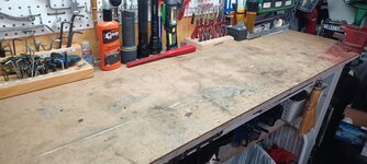

I have taken my tool box off my work bench as I have bought a new Craftsman rolling cabinet yet to come in. I have painted my work bench so I am now looking for a nice rubber mat to put on my work bench so I don't mess the paint up.

I just finished up my main workbench last October. I went back and forth on what to coat it with for quite a few years and finally settled on some type of rubber.
If someone was on a budget, I would recommend the 12" tiles from Lowes. They are $.69/tile and are about an 1/8" thick. The downside to them is the good ones aren't adhesive backed. If adhesive backed is desired and you are okay with a wood look, the vinyl planks look pretty decent.
What I ultimately chose was a solid neoprene sheet in 1/8" thickness and 60 durameter. So far I am really liking it. It sort of "grabs" the item I'm working on so it doesn't go skating across the surface when I apply some side force. I have an aluminum lip around the perimeter of the top to capture the rubber sheet and so far it's holding it well without adhesive. No adhesive will also allow me to flip it over to get some extra life out of it if/when it gets scarred up.
Home Depot actually had the best deal per sq ft for the size I needed on the main section, but ebay had a better price on the mat for the smaller area. The point is, shop around for the size you need because prices vary a lot per sq ft.
Anyway, just food for thought.
