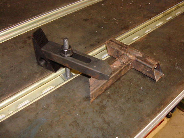

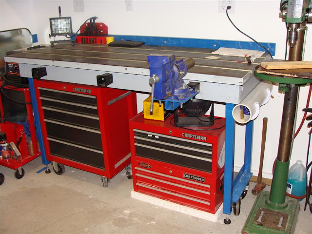

Here is my addition to this thread. I have posted my bench in its own thread as there are alot of details but here is the jist of it:
It uses strut channel for T-slots so that i can clamp anything down. Has hitch receivers in the front for mounting vises and other "bench top" equipment. Casters that can be used to move it but has threaded feet that it sits on when stationary for leveling. And a simple storage system for recoil air hoses.
See the thread below for more details.
http://garagejournal.com/forum/showthread.php?t=57193
