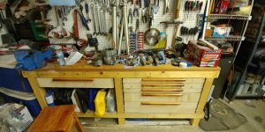

I'm looking to build a new workbench for my CNC mill (350 pounds) and CNC lathe (250 pounds). Probably about 7-8' long. 3-4' deep.
I quite like the design at the bottom of this post here (the picture with the 2 kids crawling over it). No clue where it originally came from.
The other attached drawing (came from a thread over at CNCzone) looks more finished but has a lot more joints (pocket screws?) and I'm not sure on it's rigidity.
Before I start building, curious if anyone has any pearls of wisdom. I'll probably use 6 4x4 legs (rather than 8).
For the top, probably 2 pieces of 1/2" plywood glued together. I'm not sure if this is a good surface for this weight of equipment. Covering with a thin sheet of steel plate is an option but steel is $$$ right now. Long term I'd really like a concrete top but a) that's really heavy b) not sure if this is the best structure for it.
Not sure on whether leveling feet (or combo leveling casters/feet) are a good idea. I don't have any major need to move the bench around the shop.
Short term I just want to get the machines off the floor and onto the basic skeleton frame of the bench. Longer term I'll add drawers and shelving underneath.

Sturdy is less of an issue than stiffness is. When the CNC is going back-and-forth or side-to-side, you want the table to resist rocking. Make sure you add some cross-braces if made of wood.

Use 6x6 for the legs & rabbet the top of them to take 2x6's so the edges of the table are flush with the legs.
Cut 2x's to run front/back for the top, then top that with 3/4in ply (at the very least)

I had a 3/8" bench top folded by a fab-shop. The base legs are 2" square tube with X-bracing. I have a BEACH toolbox base under the late table.
The box showing side cabinet is a MAC. The MAC went to a new home.

My vote would be to base your design off of this standard table.
http://www.eaa1000.av.org/technicl/worktabl/tablefig.htm
It's nothing but 2x4's and simple to put together, but by overlapping the pieces the legs transfer the weight directly to the floor. Instead of other designs where the weight is transferred through fasteners.
The top is framed, so you don't rely on plywood top to resist flex, but the 2x4's which won't be bending with that amount of weight.
My take on it was a 6 leg design, with two pieces of 3/4" ply glued together.

Steel square tubing legs, angle iron top frame and a 3' x 80" solid core exterior wood door slab.
Will be going to the rebuilding center this weekend to try and find a door slab.
Stopped by the steel yard today looking for surplus. Nothing in 2" square but they're cutting some 2"x4"x1/8" for a customer and will have 3-1/2' remnants so will be picking up 6 of those later this week for $45.
Got seven 4' sections of 1-1/2" x 1/8 square which I'll use for the top/horizontals. More weld contact than angle plus they didn't have much angle.
The angle they did have I'll use for the lower horizontals.
Should be about $100 all in, plus whatever the top costs.

Plan on having drawers at each end and center portion shelves.
Sent from my MI PAD 4 PLUS using Tapatalk
bad_idea
Jun 11, 2011
4,338
Pasquotank, NC
I find elbow height is ideal table height for detail work. Waist height is ideal for work requiring power tool use, hammering/prying or moving heavy items. I haven't worked with mills or lathes much. If I understand correctly, these are automated machines - so you just need to load metal into it, push start, then unload item. If that is the case, then I would think waist height would be ideal for a working surface.
Will both machines be facing the same side? If so, I would make 24" deep drawers on the front side and 12" open shelves on the other.
