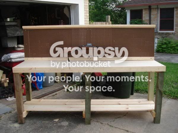

If you can see the photo/drawing: what I have done in the past, make 2x4 uprights attached to the bench legs with carriage or lag bolts, attach pegboard to uprights, attach power strips on the sides of bench or pegboard, the one I built had a shelf on top-with a fluorescent light hanging from the bottom-plugged into the power strip.

This is pretty much what I was looking for. I may try this out, but have a few "rookie" questions if you don't mind:
1) What did you use to attach the pegboard to the uprights?
I took coarse thread drywall screws, small flat washers and screwed the pegboard to the 2x4 uprights. If you are hanging heavy tools on the pegboard-I would put a 1x2 across the middle between the uprights as a support-as the Masonite/pegboard is not all that strong.
2) With the shelf, what kind of wood did you use and how did you attach it?
I used a yellow pine 1x12. I screwed the back into the top of the uprights. I cut the leftover 1x12 into triangle gussets and made supports for the shelf. You could also attach metal "L" brackets to the uprights and support the 1x12.
3) In the attached picture, you can see I have a "lip" between my top surface and the 4 legs. Therefore, if I put 2x4 uprights on the back, they would not be flush with the legs. How could I attach it on mine?Depending upon the gap between the benchtop and the legs, you can cut a board that is the same thickness as the overhang of the top and sandwich it between the leg and the upright. From the pic it appears to be a 2x, so just put another length of 2x4 between the top and the bottom shelf of the bench and it will make up the difference.
I really appreciate it! Also, do you have any pics of your complete bench? This is perfect.
I will dig to see if I can find a pic... I made it for a friend who was a gunsmith-and he passed away a couple years ago.

Bingo! Found it....on a previous post on this wonderful forum!! This was before I added the shelf on top...

Agreed if you are going to be using the bench for heavy work-I have a post vise mounted to my wood bench, built with 4x6 legs and a heavy 2x4x8 on end top. I beat, saw, file and do a lot of heavy work on it-it doesn't move much. My friend that I built the above bench for used it for rebuilding SKS and AK type rifles that he sold. He wasn't doing too much heavy work on it. The shelf was used for boxes of clean rags and other light weight stuff. I never thought about swinging wrenches.

Mesquiteforge's drawing is the way to go. If your final height is as short as his pic, then I'd put the powerstrips on or attached to the underside of the top shelf. I've seen pics of some bench-and-pegboard setups that had box sections attached to the bench top at back that boxed in either regular outlets or powerstrips with a little shelf on top, then the pegboard going up from there. They look nice when constructed with care, but for me the cords would always drag across the bench knocking stuff off, etc.
