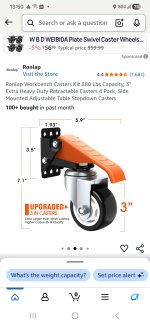

Needing a 24 X 30 inch workbench 36 inches high. Looking at building something like the image below. However, it needs to be 36" tall without wheels. The bench legs should sit on the ground with some way to put wheels down in order to move it. I know they make Retractable Casters but these will stick out too far and I need the footprint smaller. Table must be steady when complete. Any ideas as to how I can achieve this?

Thanks. I saw the Holkie ones. I'm too old to get down on my knees and move the levers. I also looked at a video of them installed and the pads are "springy" - not solid/sturdy. The pin skate won't work with the area I have around the bench.

I used these recently on my benches purchased off amazon, they use a cam locked wheel for rolling, and when not needed unlock and fold out of the way:
What is the distance from the table leg to the end of the orange lifting handle? And how tall is it from the top of the mounting bracket to the bottom of the table leg?

The wheel isn't on the ground. It's just touching. When you raise your bench the mechanism lowers the wheel and locks it below the bench foot. Raise it again and it releases it so it doesn't have the bench pressure on it. Check the video here: (scroll down on page))
