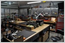

I use 3/4" plywood tops. If needed I can throw on 1/4" rubber mats cut in various sizes depending on the project.
