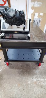

Timely subject as I am about finish a new shop. I have a menagerie of benches in the existing garage. None of them the same height. I'm thinking to consolidate two of them into one 12ft bench. Only problem is finding 12ft of material in one piece.
Suggestions?
This is what I'm looking to consolidate. Likely do a STEEVO style setup and get rid of the old black and red dresser.

I may have missed it if this has been mentioned, but have you considered finding old bowling alley lane material? Search on that in this forum and you’ll find some examples. I don’t have personal experience with it.. except for when I’ve thrown 12 lbs balls on them.

I built a Steevo style bench that is about 13 1/2 feet long. Had access to a lot of good 1/2” plywood at the time, so I made a laminated top from 4 layers of this - then had a piece of 1/8” steel bent to fit over the top. I have beat the **** out of that thing for years and it still looks great!
Yes, it's pretty expensive but there is a supplier in my area. Great stuff.
