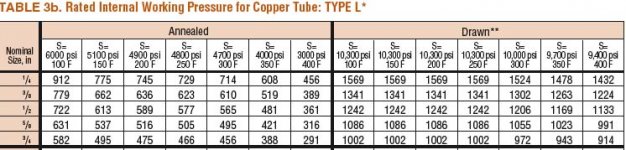

Mike F
Jan 28, 2006
197
Long Island, NY
Though I do not have years of shop experience around compressors, I did quite a bit of research before configuring my compressor setup (which is a work in progress). One of the references is The Copper Handbook, from which I found the following info. Of course, if joints are not sweated properly there can be leaks in the system, but otherwise the numbers are quite favorable for anything most of our shops will be seeing. What seems to be key here is to use the proper solder- 95-5 tin antimony. Of course if you have some mammoth compressor for factory use, that's another story.
