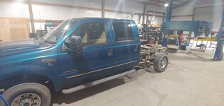

Installing rear air bags on my 2014 truck. Need to remove the rear jounce bumpers and it has been a nightmare. Above the axle, inside the frame rails with brake lines, exhaust, gas tank and wiring in the way. It would be nearly impossible to get anything in there other than a standard box or open end wrench even without the “utility” lines. Can’t see the nut and the head of the bolt is a large steel pipe encased in plastic that doesn’t turn because of a notch in the frame.
Got a box end on one and was able to get a few very difficult turns on it before it seized. Not enough leverage to break it off. The other one won’t turn at all. Not enough clearance to get an air chisel to stay on. No chance of a recip saw or angle grinder. Cut off tool will fit, but the blade won’t reach with the angle I can access it. My torch and plasma cutter are non-starters with everything in the area. I broke two nut-splitters which don’t work too well because they are flange nuts.
Cut one of the bumpers to get access to try to drill, but the axle forces the drill to engage at an angle, and since there are multiple pieces the bit keeps running and grabbing before breaking.
I’m going to try an oscillating tool tomorrow when I can get blades for it. I’m hopeful, but not incredibly optimistic.
Honestly would have been easier to pull the bed.
