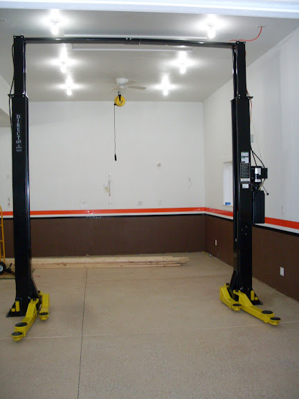

wrhenker
Jul 15, 2009
34
Joliet, Illinois
