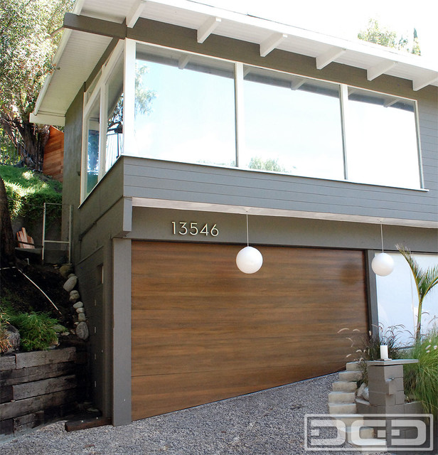

As long as the tops of the doors are level with each other it seems like it should look fine. It is not unusual for the bottom of a building to follow the terrain & the top to be level all the way across. If the doors have panels or horizontal lines match them at the top. Leave any differences at the bottom of the doors.
I can't find a pic that matches your situation, but the pic below is an extreme example of a terrain change in a single door. The top is level & looks right with the house. The bottom follows the terrain. It would look far worse if the entire door followed the terrain. I think the same holds true for 2 doors with different floor heights. Maintain the distance between the door tops & the top plate. Match the tops & it will look right.
