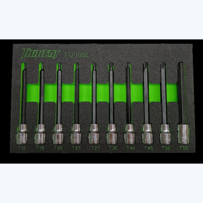

would you say wera makes these torx sockets?
ozaudio
Jun 8, 2020
99
uk
sealey do 2 lines, standard sealey which is just like draper and all the other china imported stuff, then then do sealey premier which seems to be the decent companys who make the tools for them, i did ask sealey are the torx made by somebody half decent, they wouldnt even give me a yes or no answer, what do you think ?
Dave455
Mar 19, 2013
5,844
Sussex, England
No, they’re not Wera.
Although the Sealey are clearly made “in the Wera style” they are equally clearly, not the same., or even close.
Personally, I couldn’t be bothered with ‘em.
Dave455
Mar 19, 2013
5,844
Sussex, England
Just to help you out, having spent a long time on this road, the first thing to do is look at the details. Really look, assume nothing.
Can you see how the two sockets are different shapes? Look at the curve where the diameters change. Look at the crowning where the socket meets the bit.
Now look at the knurling, both style and size. Now look at the proportions of the socket.
Now look at the bit. Look at the relative lengths, look at the shape, especially where the hex changes to round.
Both completely different.
Now consider this, if Wera were contracted to make tools for a third party, there might be differences in finish, but they would use the same sockets. They would use the same size bits. And they would be very close to Wera price. Might be a frac cheaper - couple of pounds - not a third the price.
So, all things considered, what do you think?
So if somebody is ripping off a Wera bit socket, and can’t even get the basics right, what hope is there for the things that really matter such as steel quality and heat treatment?
None whatsoever!
