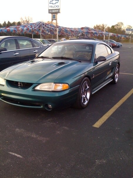

I own a 97 Cobra i bought new, it has less than 15K on it and totally original It's never been driven in the rain and only thing i have ever changed was the battery and just last year the tires.
This thread caught my eye for sure. Thanks
