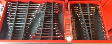

Four years ago I made this one for my combination spanners
Before;
And after;
It was an off cut of dense foam that I "cored" with a 5mm drill bit, then cut channels from with a sharp blade. Not the neatest, or even straightest, but not bad for a first attempt. The result was what I needed - able to quickly select the size I wanted (although you cant see the sizes, I know which is which as it runs 7 through 19 mm) and the foam grips the shank of the spanners so they don't move around - important since at that time my box was a mobile van box.
I have another two sets of spanners, both metric and both ratchet - one set flex-head and one set fixed. The fixed ones always remained in their supplied case, and the flex-head ones in the plastic rack/holder that came with them, but that took up a lot of space due to how they were arranged;
So a new one was fashioned this morning using some hard sponge type foam and a glue gun. Just cut a base-plate to shape, then cut strips, roughly 10mm wide and hot-glued them down leaving space for each spanner to sit snugly in it's "channel". Doing it this way meant as the spanners got smaller, the channels could get thinner with them, but also meant that they don't all sit at the same height since they were sitting on a common height base plate. But that's not big deal.
Now they can sit in a much smaller drawer, taking up a much smaller space, and I can get the fixed-head ratchet spanners in there too
I could have just bought one of these, but mine was more fun to make

Nice work Matt!!! They look great.
I can never cut foam that straight!!!
Matts is pretty easy design to do as foam not over thick and ribs are glued on.
As long the foam decent then it cuts pretty straight with razor blades.
I'm doing some of these reorganise my wrench drawer for new additions and easier handling and tracking of awol tools .
Better than retail racks as can make to match sets you got, harder do tilted wrench slots though .
