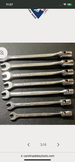

might want to add double open end super thin wrenches at some point and you also got stubby combination wrenches

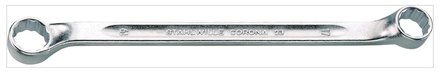

I read your post and a set of 75° deep offset double box would complement your arsenal.
Stahlwille are highly recommended.

Some conventional open ended wrenches are a good addition. Generally not costly or bulky, slimmer than a combo, and perfect for some roles.
I use slim open enders quite often. I hardly use them on tappets now, but often need them to stop a ball joint turning, and these are all that fit. Not all makers offer these.
Flare nut wrenches have been mentioned. Yes, definitely add some of these.IMG_1390.jpeg
It’s also worth having a thick open ender, for hose connectors that just have a couple of flats. The Snap On flare nut wrench above (a superbly thought out tool) has such an open end.
