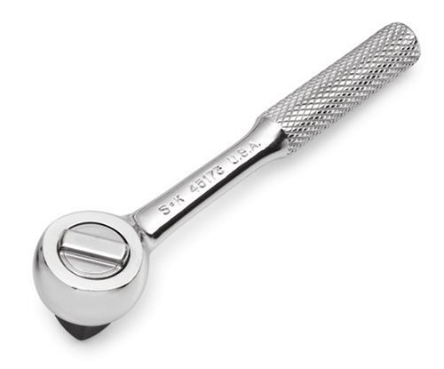

Wright makes great tools, however I have the S-K 45173 and I freeeekin loove it :rocker:
It's fine tooth, inexpensive, comfortable and made in the USA. I have not compared it to the wright, but you are probably doing good either way.

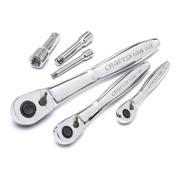

I wasn't crazy about the tooth count anyway. I'd prefer a 60T 3/8" drive in the body of a Craftsman Thin Profile. I love my USA thin profiles. They were the last good thing Craftsman made.

If you're ok with the round head ratchet (guessing you are since you did try the Wright), I'd recommend the SK. You can buy 3/8 in 1/4 body from them in all the same handle styles as the normal 1/4 ratchet...standard, long, and flex. You can even piece one together like I did, using a cheap 40970 from the flea market, and the 3/8 thumbwheel ratchet repair kit.
I usually prefer Wright round heads over SK as a general rule, but in 1/4 drive, they have Wright beat in smoothness with 60t action. Head is a bit larger, only downside.
