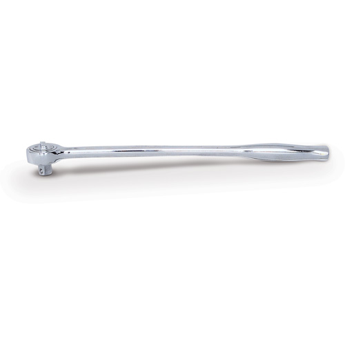

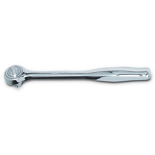

I'm looking around for 1/2" drive ratchets in standard and long lengths. Not wanting to break the bank with SO, but I'd like something halfway decent that I can be confident in as I hang on the end of it.
The handle on these Wright ratchets looks pretty comfy. Could anyone offer thoughts on how they feel, both in hand and performance?
Also, I see mention of them being an SK equivalent. What is the tie to SK? Do they use SK ratchet internals or something?
If I ever need warranty repair/replacement, who is Wright Tool and how are they to work with?
Thanks.

I have a 1/2” long handle version of that ratchet that Wright made for Mac.I find the handle quite comfortable and works well. Wright is a tool mfg. who had been around for many years. I also really like their combination wrenches. As far as I know it is similar in head shape to SK but not made by SK.

I have both the contour grip and knurled grip models. I find the contour grip to be a little slippery when I'm working on a super oily/greasy project. Otherwise, it is my preferred ratchet. No tie-in with S-K at all other than the knurled grip ratchets and their internals look vaguely similar to the traditional S-K round headed ratchets. I've only had to call Wright twice in the years that I've been using their products. Both times I spoke to a real human and the interaction was smooth and successful on the first try.

The square profile handle looks pretty uncomfy to me in the photos but obviously YMMV.

So the Wright contour grip ratchets are pretty nice. They clean up nicely. A bit heavy overall but it is balanced well. They will get slippery versus a comfort grip or knurled handle but it isn't as bad as the smooth handles on my Williams ratchets. The heads aren't as large on the Wright ratchets as their SK competitor and the dual pawl mechanism, once broken in, is very smooth. Maintenance on the ratchet is really simple. Socket retention on the square drive is really good, though there is a bit more wiggle with my Wrights versus my SK ratchets. It might look uncomfortable, but I can assure you that the contour grips are very comfortable. The square drive on the Wright is chromed, so I know some dudes online have complained about that. I haven't had any issues with mine as far as flaking.
You cannot go wrong with either but I do believe the Wright ratchets are cheaper than the SK in price. Another option, and one I highly recommend, are the Proto round-head ratchets. Slimmer heads than the Wright or SK ratchets and they have better knurling than the SKs. The standard 1/2 is just under 10" I think while the longer fixed head is 15" and the flex head is 17". Italian-made, so if MiUSA is your thing they won't make the cut.
As far as the warranty, I have never had to use Wright for that so I cannot comment on it. SK is all over the board. I've gotten lucky and spoken to someone on the phone right away, other times I won't hear back for weeks or months if I send an email. Personally, I've not been a huge fan of SK's customer service and their consistency on their sockets and ratchets hasn't been on the same level as Wright's. Proto has been very good to me on the few occasions I have had to use their warranty.

I have the long and standard length versions. They are super comfy, quality is great and the chrome finish is superb.

I have the long handle Wright contour grip ratchet in both 3/8" and 1/2" drive. They are excellent tools that will outlast you. The question you need to answer is if you prefer a round head design to a pear head design.
