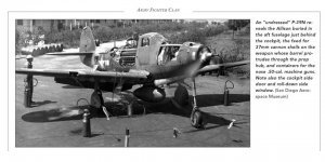

30,691
I was looking around for a technical manual today with no luck. I did find a related document that is snippet only view that I have requested to be unlocked. We'll see. In the meantime, just some eye candy excerpts from a few other documents. Pic 2 would be nice to have. There are digital copies available for $15.
