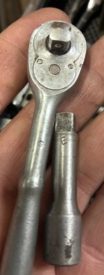

OneEyedMan
Sep 4, 2015
158
Just for fun, here’s a small handful of 9/32 drive “E” sockets and a “G” stamped ratchet. The extension and ratchet look hand stamped. These are from my 9/32 and 5/8 drive Snappy drawerIMG_2098.jpegIMG_2099.jpegIMG_2100.jpegIMG_2101.jpeg
