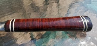

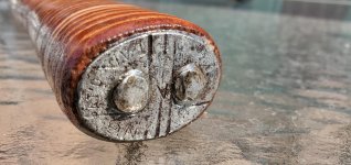

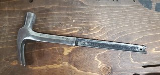

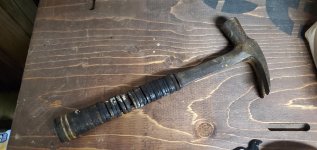

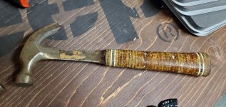

So far, the biggest project I have undertaken is the 28oz Estwing Hammer. This was my Grandpa's hammer and started out as something fun to start play around with to go with my new Estwing Hatchet. But after trying to bring the leather handle back some, it was just too far gone...so I decided I would completely strip the handle and do a full restoration!
As I started pulling the leather, it was clear that it was a good decision as the leather just started disintegrating and was definitely done. Once the leather was gone, I removed the end plate and got to work sanding with a 1"x30" belt sander with various grits and surface conditioning belts. Then from there, I when to finer grit hand sanding working up past 1000 grit. Then using my Dremel I used a few various wheels to finish the sanding and then polished with small buffing wheels and Purple metal polish.

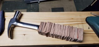

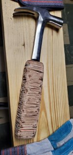

Next, I got to work reassembling the handle. I grabbed my leather punches, and got some 4mm thick vegetable tanned tooling leather and started cutting 1"x2" squares of leather and then punching out the handle shape in the middle of them. This process definitely took a good amount of time, but is a fun process to learn! I also decided that I wanted to add some color strips back into the handle like the original design, but I still wanted to make it my own. I found a material called G10 (plastic like, .060" thickness)) and chose to do a color pattern of White-Orange-OD Green-OD Green-Orange-White. And I stacked all of these onto the handle with a nice tight fit!
Once the handle was filled, I then peened the end cap back on using a Ball Peen hammer on both ends and a small butane torch to heat the ends of the rod slightly to make peening easier.
Then lastly came the shaping which was a variety of sanding, cutting, and sawing to get the shape where it is today!
I will finish the hammer in the lacquer finish which it originally came in, but I haven't quite gotten all the way to finishing the lacquer yet, but I am so happy with where it is currently and I can't wait to see it finished!

Was able to just about complete the 28oz Estwing Hammer this past week! Came out pretty nice! That is two coats of lacquer on the handle! The first coat really soaked in fast and left the handle rougher still, but the second coated smoothed it out just about right and the leather still has a nice grip and just that little bit of give that the leather handle provides for the shock reduction!
The lacquer process I used was pretty simple! I got a can of clear lacquer and a SmartWater water bottle. I cut the very top off the bottle and then poured the lacquer in, leaving enough space for displacement when the handle enters. I then dipped the hammer in a few times and let the excess run off, and then made a little drying jig with some extra wood and wire I had laying around! Worked perfectly and the end result is great!
