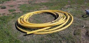

This gas line is excess, can it be used as conduit for underground run?

Not shown in the NEC as a recognized wiring method so I would say no if you wish for code compliant work.

You could use it if you pull wire rated for direct burial. Then the line is simply extra protection or a chase since the wire is not required to be in a conduit.

I am touchy about non electrical pipe being used as a underground conduit ever since I cut a white PVC line to get it out of my way repairing a sprinkler, only to find 14/2 UF inside it, you can only guess what a pipe is by it's color underground, use the wrong thing and someone coming behind in the future has no idea.
