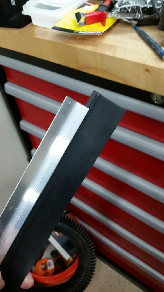

I had the exact same type of trim around both of my garage doors with the channel to accept that style of seal. Given what I've seen of that type of seal on my front door, I don't think it would hold up over time for an overhead door, especially given how tight your door fits to the frame. As it is, my front door seals need replaced every couple of years or so due to tearing, at least on the hinge side.
The trim on mine ended up rotting (they left it in direct contact with the concrete, so it was inevitable), so I had to replace it all, which ended up being a much bigger job than anticipated.
I previously used brush seals to go around my doors. They held up reasonably well over the years, but eventually started to fan out/fray. I decided to use a different style of aluminum retainers this time around with rubber seals:
Certainly not cheap, but they were pretty high quality, and I think they do a pretty nice job of sealing around the door:
Bonus points that the aluminum retainers accept 3 different seal materials with different options available for each material: vinyl, rubber, and brush.
I'll have to see how it holds up over time.
If you are happy with no seals (and I could see why in Texas), just leave it as is and put your time and money elsewhere.
