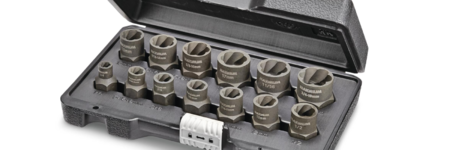

Oh yeah, I also have a set of extractor sockets.
I'm in Canada, so I bought the Canadian Tire "Maximum" brand. In comparison to my internal extractors, I cheaped out on these. I think they are an unbeatable value when they go on sale though. I figure its not as risky to buy cheaper extractor sockets - they're way less likely to break and if they do, you can get them off easily (and these have a lifetime exchange warranty).
Since buying them, I've yet to have an opportunity to use them. I'm sure I will eventually though. In the past I've done workarounds like hammering on the next smaller sized socket or filing the flats of the fastener. I figure it's nice to have options.
