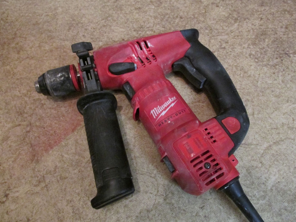

I'm always a believer in more power, so 8A over the 5.5A Milwaukees. I use my 0300 in my notcher with a 2 7/8 hole saw in 2.5" pipe and for a Milwaukee this is just use, for a HF drill it'd be abuse. The only thing the Milwaukee abuses is my left arm on the aux handle, and my nerves.

I've used the Milwaukee 1/2 in hole shooter for years. You guys who complain about the torque need to go find the side handle that came with the tool and use it.
