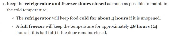

...I don’t take my generator out until I’m past 4 hours and looking to preserve whatever I had in the fridge/freezer...[/QUO
For info, this is from the FDA
