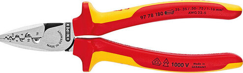

your thoughts on wire ferrule crimpers
laser3kw
Nov 17, 2012
7,276
northen IL
I am adding wire ferrule crimpers to my electrical tool supply. I am acquainted with them from past electrical designs in machinery cabinets. What is a good brand and do you prefer square crimp or hex (and why).
I have been cruising Ebay and have a feel for the cheap stuff and for the expensive stuff. This will be lightly used tool and I would like to see the range from 22ga to 7ga? Also, the automatic adjusting is a must.
thanks for looking

I bit the bullet and got the Knipex ones.
As suggested, I took a look at the Knipex 97 53 14 model, hex crimp. I seems to be in the ~$200-ish range.
The square crimp model seems to have a lot of Chinese knock offs, similar color combo and general appearances.
I also found Preciva hex crimp model that seems to have good reviews. Still looking for that balance of price and quality. I am not afraid to pay up for the right fit.

I got the Preciva kit on Amazon. For a Chinese tool it's high quality. I can't justify the cost of the high end models for a tool I only use a few times a year and don't NEED.
IIRC the Preciva kit even came with a thank you note and proper instructions.

As mentioned above, for cage terminal clamps that grip the wire with flat/rectangular jaws, the square type are ideal. For terminal blocks that have curved jaws, the hex are ideal. The trapezoidal shaped crimp dies are generally a compromise for non-encircling type crimpers with only 2 jaws. (This is abstract, all types can meet the standard for use on all terminal blocks.)
Another thing to be careful of is that most ferrules available are actually designed for metric wire, and relabeled by the vendor, so may be slightly off for AWG wire, which can leave excess material hanging off the corners after the crimp in some cases, especially in the hex/square self adjusting type. (The trapezoid type inherently has provision for the excess ferrule material to flash out in the corners.) Some ferrule vendors sell "true AWG" sized ferrules that I'd recommend when using AWG wire.
The Knipex/Rennsteig self-adjusting ones are very nice, you could make an eBay saved search for them .

The two self-adjusting ones will be infinitely more convenient than finding the right opening every time. There is a variant of the front-loading one that has a switch to do even bigger ferrules. Choose the one that seems more ergonomic for your use case.
The Tempo ones seem overpriced for what they are. (That is a rebranding of the Paladin 1300/8000 family of crimpers/dies, if you already have stuff in that ecosystem... they are adequate but I think I’d pay like max $20 for that one, it does not feel premium in any way, with pretty high hand force on larger terminals. The PA8000 frame feels better, although is bigger and heavier.)
The latter two Knipex aren’t controlled cycle (ratcheting) and should be avoided.
If I couldn’t spring for one of the nice Euro self adjusting, I think I’d rather have a well-rated copy than any other style.
