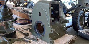

I had picked up two Dodge WC half-ton transfer cases some time ago, so pulled them out and will use one for the VC. I have to switch the mechanic yokes to the Detroit style yokes:
Donor transfer case for the harvesting of the Detroit style yokes on the left with the NOS transfer case on the right. I hem hawed on trying to figure out if I should open up the NOS transfer case or leave it as is and just change the yokes and seals:
The Detroit yokes look great. No wear grooves in them. That's great!
I like taking off the Detroit yokes vs. the mechanic yokes. Barely can get to the mechanic yoke cotter pins as they are recessed down inside. was a bit of work to get them out:
Oh hell, popped open the NOS case. I just couldn't stand it. I'll replace the gaskets, seals and get everything cleaned up. Oh well:

Also finished up the transfer case:
Hulking this thing up with one hand and trying to install the bolts, shims and rubber insulators is a workout. Still think a third hand would be a good mutation to the human body. Darn thing must weigh about 80 to 100 lbs.
I kept noticing the shocks, or shock links actually, didn't look quite right. Seemed like the were in full rebound, or at their limit of travel. I had some NOS long straight shock links, so heated them up and bent them to fit. Did add a little extra travel where the arm sits in the middle of its travel. Probably just over thinking it as usual:
I had some NOS cage nuts for the transmission that are actually good. Had about 10 others that just had a hint of rust on them which makes them useless. Really a bummer. I guess it's good to have a couple good ones:
The transmission is pretty rugged. Looks like it ran for quite a while without the speedo cable on. Also had a standard nut holding on the parking brake drum. Usually they are a castellated nut. It did have a cotter pin in there to keep it from backing all the way off, but the nut was still backed off about an 1/8 of an inch. The nut was large where I couldn't get a wrench or a thin wall socket on it, so had to heat it up and chisel it off:
Some of the other nuts were quite rusted and the heads were toast. Had to weld some nuts on a few to get them off:
Overall it look pretty good inside gear wise. Some of the shafts are grooved beyond re-use. Likely due to the loose nut:
Found a castellated nut, so when I put it back together it hopefully won't back off like the non-castellated nut did:

Anyhoo, continued on the transmission the pas few weeks. Had to make a gasket for the T-case mount. Used masking tape as a template, and they transferred it to gasket material:
Finished cleaning up some more parts:
Rebuilt the shifter tower:
Transmission proper:
Had some main shaft bearings. First one was really loose, ended up using an older used one that fit the shaft better. Hoping it'll be ok:
Time to install. Had this NOS throwout bearing assembly. Even comes with the pull back spring:
