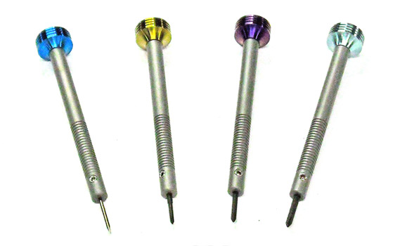

Tom Anderson is well respected in the “Everyday Carry” world for his gorgeous titanium pens and his high performing torches. However, he also makes titanium tools as well and I figured some of these might interest you guys. His precision screwdrivers, magnetic drivers, torx drivers, and t-grip drivers are VERY light, very strong, and expertly crafted in Tom’s small machine shop. They are also really damned expensive… I covet them, but admittedly don’t have a real use for the titanium jewels.

i would like a titanium screwdriver set. just some small ones. like P3 and 1/8" flat. for doing mag compass adjustments on aircraft. because all I have is this cheap flathead screwdriver that we had to make for a class out of brass brazing rod. that I hate and want something a bit nicer and non magnetic and ti seems to answer the call. Thanks for posting those ryan I might have to look into getting a couple

BTW are thye 100% ti? I need soemthing compleately non magnetic
I believe the set screws used to secure the bits are stainless... That said, email him. He seems capable of making just about anything you would need.

The term "titanium" is just like the term "steel". There are many grades available that can be used for various applications.
I only use 6AL4V (Grade 5) titanium in bar and sheet form and 3AL2.5V (Grade 9) seamless tubing. Both are alpha-beta alloys with aluminum and vanadium added.
6AL4V titanium is commonly used in aerospace and military applications because of its strength-to-weigh ratio (it has a tensile strength of 120,000 psi.) It is very resistant to oxidation and corrosion, and is non-magnetic. This grade of titanium is also used in many high stress applications for racing and, because of it's spring characteristics, it is used frequently in the manufacture of higher end folding knives.
Titanium is also hypoallergenic. ELI (extra low interstitial) alloy versions are frequently used for medical implants.

Very soft material. I have to deal with Ti screws every day, Boeing uses thousands of them in new 737, 767, and 777 aircraft. You can tear up a phillips head in a heart beat if your apex tip is slightly worn or not dead square with the screw. The stuff is quite soft.

I agree that titanium screws don't perform as well as carbon steel or stainless steel fasteners. Titanium threads also gall easily.
