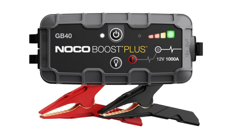

Gb40 would be tiny.
I had the 150 and it wasn't enough to start larger engines.

Issue I ran into was engines that need cranking.
Like my dump truck, ill need to crank for a good 30+ seconds.
The jnc770 i have handles that ok. The lightweight jump packs like the Noco seem to expect maybe 3-5 seconds of cranking.

I have a Noco JB70 and it works well with everything I've thrown at it.

I have a GBX45 for my 3.4L 4Runner and it has performed admirably over the past few years.
If you're going that small (40) I'd recommend going to the X series for only a few dollars more.

Ive had the GB40 for a year and used it once to start a 5.7 hemi, no issues.

Just had my first *bad* experience with the usb-c GBX newer version. Arrived to the airport after a 4 day trip and my back trunk light was on the whole time. Battery dead. In fact it was under 7 volts initially because the NOCO gave me an error code which I read was from the main battery being too low. I shut all the doors to turn off the cabin lights and waited a few minutes. Then reconnected the NOCO and the error went away. I assumed the battery came back up above 7v without any light loads on it. Then after a few seconds the alarm horn beeped because I had opened the door with the FOB emergency key, but that was too much load and the voltage dropped again. The NOCO showed 3 bars out of 4, so I thought it would be enough. But surely was not! Moral of the story, keep it charged and check it every month.
The new GBX usb-c doesn't appear to hold a charge as long as the older micro-usb GB version. I have one newer version and two older ones and the older ones hold their charge longer. The other strange thing I noticed is when turning it on, it showed 3 bars (2 red 1 orange) lit up and it couldn't even power on my car. But when connecting to a charger, it started charging and blinking only 2 red bars - so it surely wasn't charged up to 3 bars. Pulled out the older style version from my wife's car when I got home and it was still green with 4 bars. Both were topped up on the charger at the same time. I would only have thought the versions used the same battery and they only changed the charger plug style. That would make sense, but maybe not, there may be other differences.

I have significant experience with the Noco jump packs in a commercial fleet setting. I had a couple dozen of the GB40 and GBX55 units in construction vehicles. If the packs didn’t start the vehicle it was typically user error because they were not hooking up correctly, not hitting the override button when the battery was under 7v, or the pack had been in the back of their truck for 1+ years and wasn’t charged. Every time someone reported that the pack didn’t work and was charged I was able to use it to start the vehicle when I arrived. Most of the trucks were 5.3L or 6.0L chevys, but the guys used the packs on all kinds of equipment too.
The newer GBX packs were the only ones that failed, they have little tolerance for being run completely dead and typically don’t recover. I have read elsewhere this is caused by a charge circuit issue related to USB-C providing too much amperage to trickle charge the cells when they are really low. I personally own 4 GB40, 1 GBX45, and a GBX55 that all serve me well. I also have two dead GBX55 on my bench from work that other people completely discharged that I need to dispose of. I charge all mine spring and fall. The ones that go on the boats are lightly vacuum sealed to prevent them from getting wet.
Did you hit the override button on the unit?
My GB40 makes no mention of where this 'override' button is. I had to search the interwebs to figure out what it was when I first got the GB40, so how would common everyday folk have a clue what thats for?
They decided to label the button on the GBX.

Hey, I have one of those. GB40.
Used it once, battery died in parking lot. 5.3 LM7. Jump box showed full charge.
Just barely barely started the truck. Dunno if I should keep it or get something bigger.
