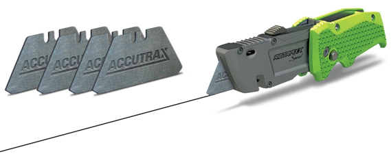

But, another little tool he had that I had never seen before were these little razor blade shaped pieces of carbon. He had them mounted in a typical razor blade handle and then used them as marking pencils against a straight edge. I didn’t wanna seem like a dumb ***, so I pretended I knew what they were all about and then went home and fired up google.
Prazi Accutrax Pencil Blade
Huh. Who knew?

Read this, then immediately ordered some on amazon.
Now I don't have to throw my extra foldable boxcutter away :D

I thought that looked really interesting but they have terrible reviews on Amazon.
I could see them being really brittle... But I will say this - they create the finest, most crisp line off of a straight edge than you can imagine... I ordered some, so I'll report back.

It seems like most people that complain of them breaking are saying they put them in a standard box cutter..
I suspect they need to go in the foldalble type, as pictured. Every standard retractable box cutter I've ever used doesn't hold the blade very rigidly- which I'm sure is bad news for a brittle material.
Probably because most people assume it comes with both the foldable holder and the "blades", and they get pissed when they open the box to find just the blades.

When you use a pencil, the lines will progressively get wider as the lead wears. Not the case with this product.

a) I don't have to buy a drafting pencil since I already have 37 folding utility knives that I've gotten for free over the years
b) I look waaaaaay cooler when my pencil is also a switchblade
The only real serious advantage I see vs. a mechanical pencil, tolerance of being in a bag. I've had mechanical pencils in various boxes and tool bags before, and the cheap plastic ones I use always get crushed by a saw or giant adjustable wrench or whatever. This thing, assuming you use a folding utility body, should handle getting knocked around in the bottom of a tool bag pretty well.
I just ordered some because they look cool. :3gears:

OK, so I got mine this morning... Initial impression is that they are VERY brittle. However, if you use them as intended I don't see that as a problem. For certain, they create a very fine, accurate, and consistent line when used against a straight edge.
Do I really need these? Nope. But I can see them being pretty handy for a guy that uses wood a lot.

I have always used the Try-Rex pencils made for kids. They sharpen easier than the carpenter's pencils and have a larger lead so they do not wear down or break as often as a regular pencil. With that said... For Father's day, my kids and wife picked up the AccuTrax blades, the Striker pencil pictured above and the Stanely handle that holds two blades and is quick change. My impression is that the handle holds the blades very secure and the line one can draw is consistent and accurate. The blades seem very brittle, but I used them over the weekend and drew on multiple surfaces with good luck. If one does not retract the blade, I'm confident that they will break off very easily or get crushed. The Striker seems more durable and the fact that it has a white lead can make it very handy. My regular pencils will stay in the drawer just in case, but for the fine furniture :) I make, these will be very useful. Can I do it with something else, absolutely, but these are cool and my family was happy that they found something for my shop that wasn't out of their price range.
