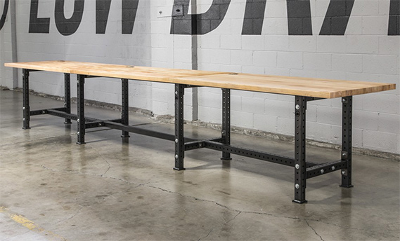

So these folks have been emailing me for a few weeks about their workbenches. I get a lot of these types of email and frankly, many of them get ignored as how many reviews can I really do before I come off looking like some kind of a flim-flam man?
Anyway, I was looking for something to post about and, on a whim, went to check out these benches. Holy cow… They seem legit. Very heavy duty, seemingly well made, and I love the modular approach that Rogue took. Given what they are, the prices aren’t too terribly out of line either.
Details here.
See Comments on the forum.

I built a couple hundred benches for a factory and used the H with a top angle like a block letter A concept where I made the ends in a jig and added it to a plate flipped up on saw horses, the stiffener steel was angle not tube stitch welded to the plate.
We used tube for the legs cause they fancied that but the rest of it was angle with 2 bottom braces at 18 inches where common sheet could be cut to fit for a shelf.
The benches above are well crafted but I could make it with 8 bolts and every other section clear span on the bottom if it didn't have shelves.
If I was building it in my shop and didn't have to ship it would weld up the connections.
When I did them went to the steel yard and cut several sheets on the shear and gang sawed angle and tube. I shortened one leg for an adjuster and still have a few scraps 20 yrs later.
I knew the guys in the fab shop and had a cut list, they had a bid dept who didn't know squat but I could pay for stuff by the hour. So I gang up 4 or 5 1/4 plates at a time and ram them thru the shear to a pallet, put in my truck, and 10 angles and 10 tubes, I could gut in 45 minutes, some times 2 machines at a time,,, ha. Maybe a ton or so, over 100 cuts and shears.
I could be back home in a couple hours and my helper would make about 3 or so before lunch without too much trouble. A guy could flip them around by hand, almost all the welding was hidden and simple, we dressed the edges with an air sander.

Those are some nice industrial-looking workbenches, but I would be concerned with two specs: the depth of their top is 36" which would make against-wall placement cumbersome for reaching anything on pegboard or slatwall behind the bench, and the 35" height is really low and would be a back breaker for many folks. Nonetheless, thank you for sharing these workbenches with us, Ryan! :thumbup:

I think it is shipped loose and you have to bolt it together. It has many holes. I was hoping it was fully welded and comes on a truck, for that price.

Makes them modular/expandable/reconfigurable. I'm sure it's to the same standards as everything else they make, which means you could set a car on that bench and the bolted connections would hold.

35-36" is the standard height of any professional workbench. I'm 6'2", and it's perfectly comfortable. Go measure your kitchen counter. That's going to be 35-36" as well.
That said, the OP's benches are overpriced, in my opinion.

I would not pay $700.00 for one of those benches for my home shop. In my professional life I bought many workbenches for a lot more than that because a manufacturing area had to be set up ASAP. We could have built them in our shop but it would be a waste of talent building something that you can buy off the shelf. In the real world it's not smart to build something you can buy.

They are not well designed as shop bench, they would have been ok if it had 2 cross braces to incorporate a shelf. That part shows lack of experience to get function right, they wrnt for form first and adead a bunch of adjustments that added a lot of cost don't do anything.
Pretty at first look but amateur design for shop.

It got so carried away with modular bolt together features that it missed good design and was done by someone who never really had the floor time to get a feel for what makes it work well.

I've been using these and 2x8s for a work bench you can put an engine on for less than $150.
I like that, the shelf could be a plank. If I was horsing heavy loads on a regular basis may add a minor brace to it and would be tempted to screw the plank to the cross braces. But minor and affordable at any rate.
I looked at the rouge again. its ok and the shelf could be planked. Its certainly well bolted. I do like the fact they seem to realize the top was strong enough without a gob of framing.
