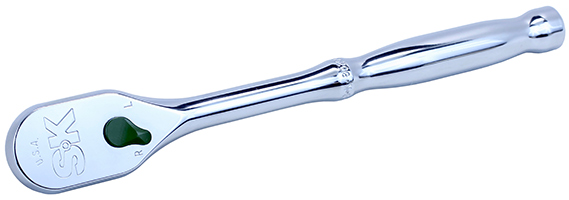

SK’s New 90-tooth Low Profile Ratchet
So I haven’t had a lot of shop time lately as I’ve been hammered getting ready for the H.A.M.B. Drags, but I did get a package from SK Tools the other day and inside was their new 90-tooth Low Profile Ratchet. Essentially, this is a 3/8″ drive ratchet that was designed to reach tight spaces (it’s only a 1/2″ thick at the head) and turn fasteners with the slightest of swings (4-degrees to be exact).
I haven’t really used the thing yet, but I’ve fondled it quite a bit and… well, it’s damned nice and tactile. It feels like a tool should and the 90-tooth mechanism is full on gorgeous. I’d say that if I paid for it too… You can get yours for a little over $90 here. Once I get a chance to use the ratchet, I’ll do a video review but as it stands I’d say it’s well worth the asking price.

I've used mine a couple times, and I agree with you, it's a very nice feeling ratchet. The 90 tooth mechanism seems well designed and I would honestly say it has less backdrag than a dual 80. I happen to like the smooth handle even though it gets slick if you have oily hands.

I used mine yesterday. It ratchets smoothly...unless it's under speed. Then it locks up. I'll be opening it up, oiling it, and stretching the spring per advice from the Garnett Tools channel on Youtube.

I agree about the knurling. It looks cool but till now my favorite ratchet has been the Cornwell SR50 which is super smoooooth. The handle on the SK feels very nice and smooooth too.

It looks real nice. I like SK tools. I may have to try one, although I can relate to liking knurling on the handle.
I must work on greasier stuff than most. I somewhat prefer ratchets with something more to grip. Last night I was putting an injection pump back on a tractor; using one of my Wright square handle mini 3/8 ratchets, which I really like because they can get into tight spaces, and I was really frustrated because it was hard to hold onto with my greasy hands. Same thing with my SO ratchet.
I prefer the plastic grip on my Wera Zyklop - even though it looks atrocious until I clean it up, and still looks ugly when you do. I'm not into how things look much, more into how they work.

Under speed?
Trying to ratchet down something at a fast pace. I'm not a pro...so I don't mind a leisurely pace normally.
In my case, I had the ratchet upside down and was palming the head like a palm ratchet to speed it up since I was reaching at an odd angle. The ratchet didn't reverse directions like the Craftsman RP's...it's lever went to the middle and then locked up.

Love mine. Bought it on Epstein's day, have used it a few times and it's definitely my new favorite. Have not experienced the "lockup" described when quickly ratcheting.

Not an elegant solution, but some Easton bat tape ($4.00 @ ****'s) should solve the slippery handle issue.
Granted, the tape is cloth-like and will absorb oil/grease/etc., but it can be removed and replaced easily. One roll will give you at least 15-20 wrappings on that small of a span.

Mine would occasionally lockup when using it fast as well. However after about an hour of use, it freed up beautifully.

Looks really nice, but having both styles, I really prefer a quick release button and that's now become a deal breaker. It always seems my gloved hands get too greasy and changing sockets, I basically have to keep a flat head screwdriver near me to pop them on and off quickly.

I think the prototype handle with the two bands of knurling is nicer than the final generic smooth handle but, maybe SK will release a knurled handle version some day. :dunno:
I find it funny that Ryan got a free SK 90 tooth ratchet since there's got to be at least 3-5 threads about the new ratchet along with it being a hot seller during the recent Epstein's day. SK should have sent him a flex head version to spark additional interest. :beer:
I haven't experienced any of the performance issues other people have mentioned. I'd like to see a 1/4 drive version and flex head versions released in time for Black Friday.:D

I'm not so sure about the green selector switch, but otherwise I love the look! That'd be an awesome ratchet to own! I'm tempted to bribe someone at school to buy one so I can use it for a bit!!!

Ah! I'm stuck in the same camp with my Snap On ratchets...but this SK is different. You won't need a screwdriver with this one. The sockets come off quite a bit easier.

I have a few of the Carlyle 90 tooth ratchets and I really like them. I think the two biggest differences would be you can only get Carlyle 90 tooth ratchets with a comfort grip handle & they're made in Taiwan. Internally they are basically the same aside from Carlyle using a snap ring to secure the gear cover whereas the SK uses screws to retain the gear cover.
